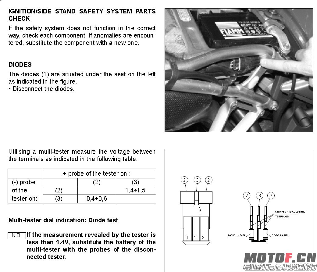

19号配件的接头 和 氙气灯的安定器的接头是一样的, 不知道能不能从氙气灯的安定器拆下来,自己接线装上去?

有个老外车友發了个有关19号这个小配件的图给我:
Okay mate, maybe one of us can buy it for you and ship it out to you. The part hold 2 diodes, you should be able to buy the diodes at any electronics store and with some care, install them into the wiring till you get the right part. IN 5404 is the part number for the diodes, make sure you install them the right way round, look at the silwer ring locations. The part you lost, had two diode's inside. Look at the 750 electrical manual on my site, all the pictures are there.

有个老外车友發了个有关19号这个小配件的图给我: 2.jpg

他说,你可以自己找两条二极管。自己做个插头/          二极管手机冲电器上面就有。
