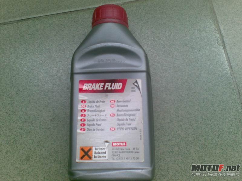

DOT4
而且最好是有帶一些顏色的那一種
顏色變了 就表示已經劣化或有水氣跑進去了

MOTUO哈!过期了!~

Motul RBF600 Racing Brake Fluid =賽車等級的MOTUL RBF600煞車油
光看乾/濕沸點的數字就知道這支煞車油算得上是極品了!
實際路駕的feedback ,就只有一個字 : 準 !!
但是它的單價真的也是頗讓一般人卻步的~
美國當地售價:$19.95 / 500ml
我們拿Brembo DOT 5.1的頂級煞車油 NT 980 / 1L來比較的話,
MOTUL RBF600(台灣售價約:NT 900 / 500ml)幾乎是Brembo的2倍!
但,相信對於那些熱血男兒/女娃們來說,相信絕對值得!!
Motul RBF 600 Brake Fluid was designed for high heat, and the high stress related with professional racing, making it excellent for any car, truck, or SUV, whether it is mainly street driven or tracked.
100% synthetic, RBF 600 FACTORY LINE is a polyglycol-based brake fluid exclusively designed for races. Developed to resist high temperatures and wet-weather conditions, RBF 600 has a high dry boiling point of 312°C and a wet boiling point of 216°C. This ensures effective braking under extreme racing or rainy conditions. Couple this with its outstanding anti-vapor lock performance, RBF 600 has become a well-trusted brake fluid in many races.
SPECIFICATIONS
Product RBF 600 FACTORY LINE
Feature 100% synthetic, polyglycol-based. Has extreme thermal resistance and stability.
SAE/DOT Standard FMVSS 116, DOT4 & SAE J1703
Specification —
Maker's Approval —
Compatibility All types of hydraulic actuated brakes and clutch systems (not to be used with silicon-based and mineral-based brake fluids).
发表于 2010-10-25 16:04:45 | 显示全部楼层
Boiling point
Dry: 594F  (312C)  乾沸點
Wet: 421F (216C)  濕沸點
資料是網上搜的僅共參考
不過看起來的確是隻好油
